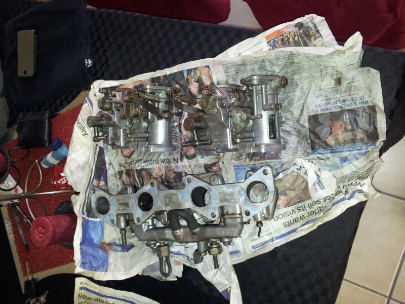

    I recently picked up some twin solexs for my ta22.
    They where off an 18RG engine and I have a 2T so the tuning is off.
    Ive tried my best to get them tuned and have got them a little better then what they where by playing with the mixture screws.
    But i have no idea what I am doing when it comes to tuning so dont want to go any further without getting some advice.
    I Just want to tune them enough to get it down to my local carb place and get them done professionally, Its so bad atm i cant drive it.
    I searched and found some guides but they all use terminology i dont understand haha so was hoping someone on here could give me a quick easy step by step guide. I can get detailed photos of the carbies if it helps to show me what to do, and also have a video of the engine running to show how shes running at the moment. Just let me know if they'll help and ill upload them.
    Any help would be great!! and thanks in advance!

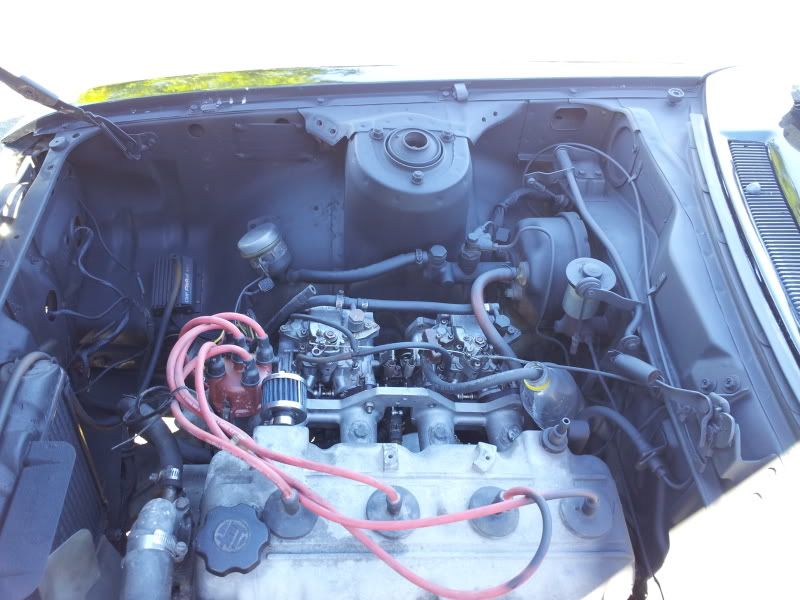

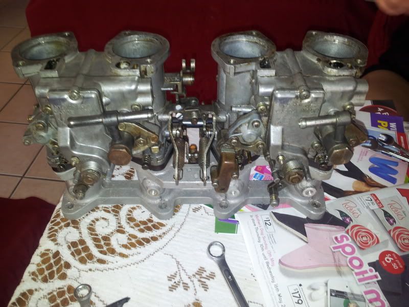

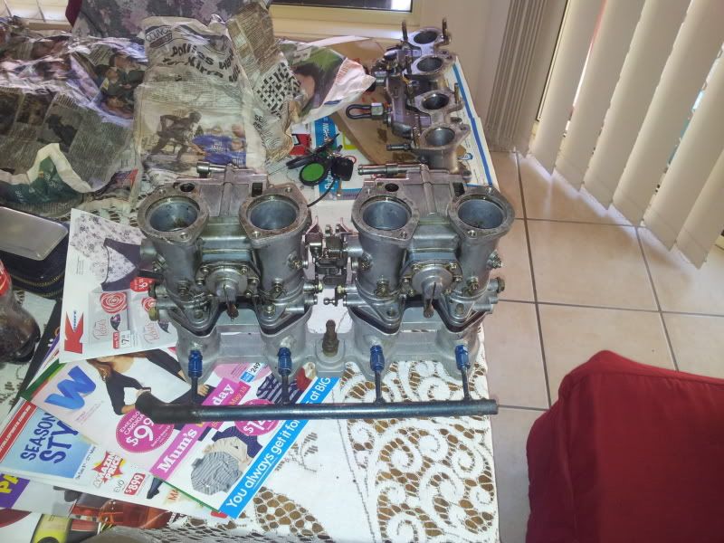

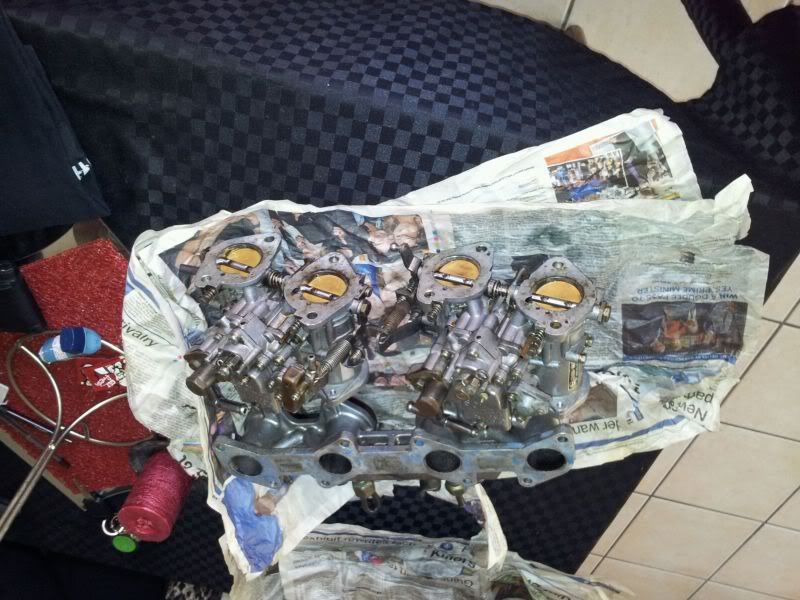

    sorry for the late reply guys, I havnt had a chance to get some HI res photo but have these on my phone-
    They arent the best but until the weekend thats all I have, hope they are some help?
    And thanks for the help! =)
    Jul 2011
    14
    Default Re: Twin Solex Carbie tuning HELP!!

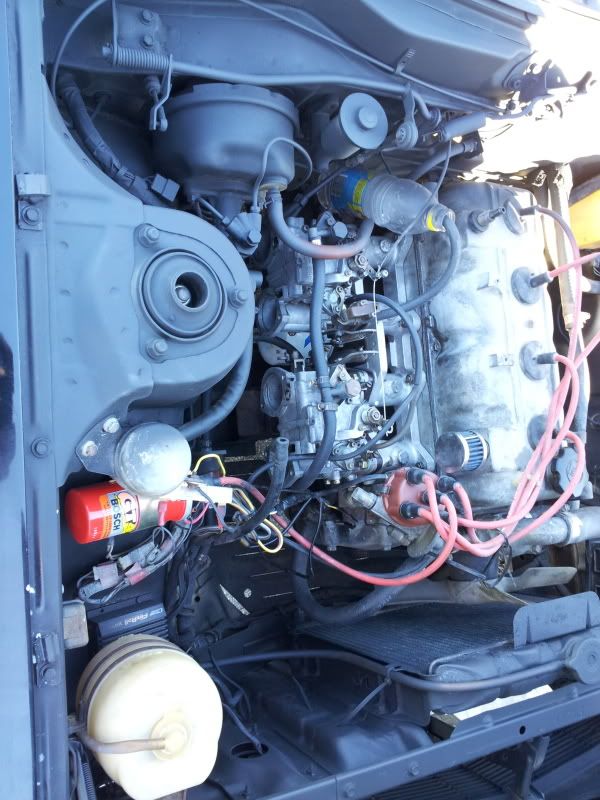

    Dont mind the return fuel tank (Plastic Bottle) I didnt have any fuel hose long enough ahha
    Also from what i can tell there might be a air leak.. When i take the vaccuum hoses off the revs should rise yes? They dont.. But there is no holes on the vaccuum lines?
    I played with the mixtures a bit more and shes a little better then she was at first, but still really bad, almost feels like timing is out, but its not. Ill upload the video of how shes running as it might help?
    Also the car timing on the car, spark plugs, valve clearances are fine, she was running fine into the old carby shat itself.
    Sorry about all the questions, just wanna try to get her running good for the all jap day

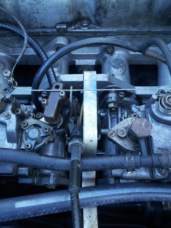

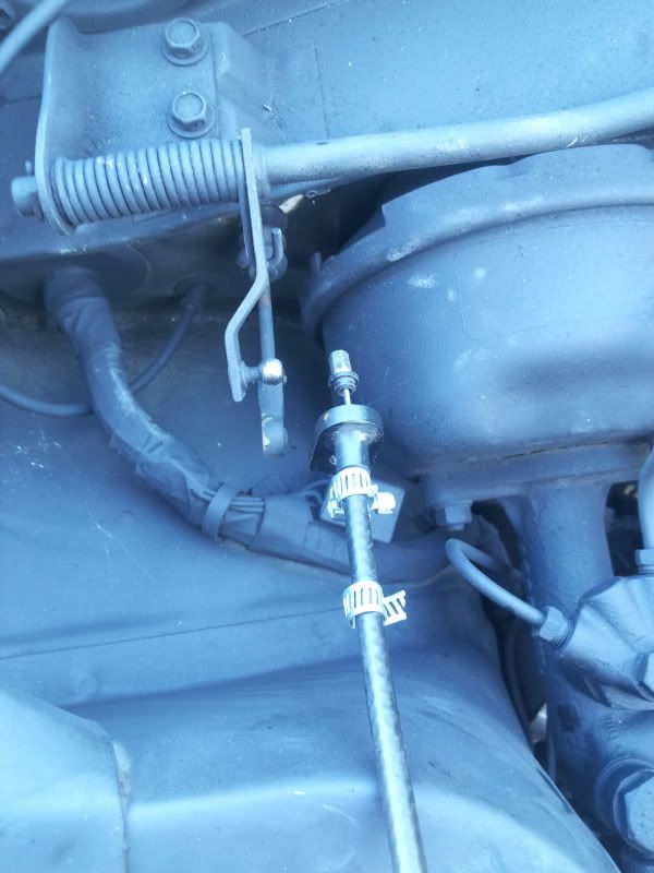

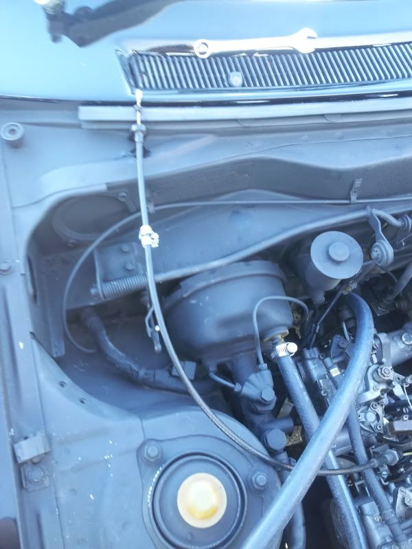

    So I managed to find an old XF falcon accelerator cable in my garage, I think I can make it work too, its almost the perfect length to run from the carby linkage to the accelerator pedal. Im uploading so pics and a video now to show how it should work. All I need to do is make a bracket on the manifold to secure the cable (like the section that holds the cable so it pulls the right way, no idea what to call it, the pics will show what I mean)
    Then need to find a way to secure it to the accelerator pedal, Thinking about doing what you done and it should work, its the correct length so fingers crossed. So you have to drill that bit of the linkage off the accelerator pedal? I was playing with it before and there's a clip on it, thought it held it on but couldn't get it off to see.
    If the one im trying now fail I will defs try this, for $6 its worth a go haha
    well here's the pics-
    The Video didnt upload, so going to re-take it with my camera rather than my phone and re-upload it soon.
    There is a spring to go in there on the cable, but i need to find a skinnier one as the current one hits the springs on the carbies. Dunno if itll need one but might help with pulling the cable back once the accelerator pedal is attached. And thats the kind of bracket im trying to make, bolt it to the manifold and secure the cable to it.
    As you can see from that pic its just about the perfect length to go to the accelerator pedal. Just need to feed it through and secure it.
