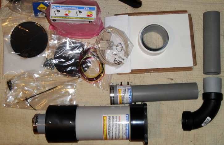

    Let me present to you (drum roll, please....) my new flowbench
    I still have to build a base/box for it, but it should allow me to do port matching (volume, velocity, and pressure).
    AND provide something tangible(like a dyno sheet) for my clients

    ah the FP1, I have used these before. Not bad little units! You will have hours of fun with these! Good Luck !

    The flow performance stuff is really good, did you get the pitot tube as well?

    I DID get it with the pitot tube addition

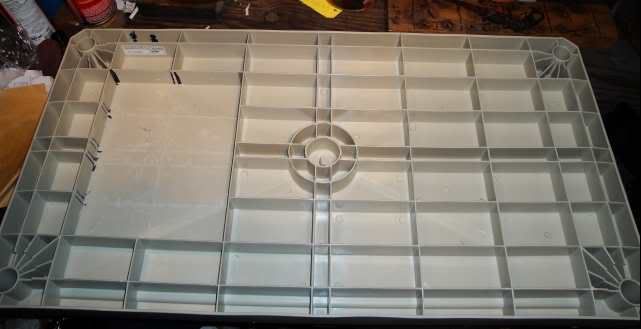

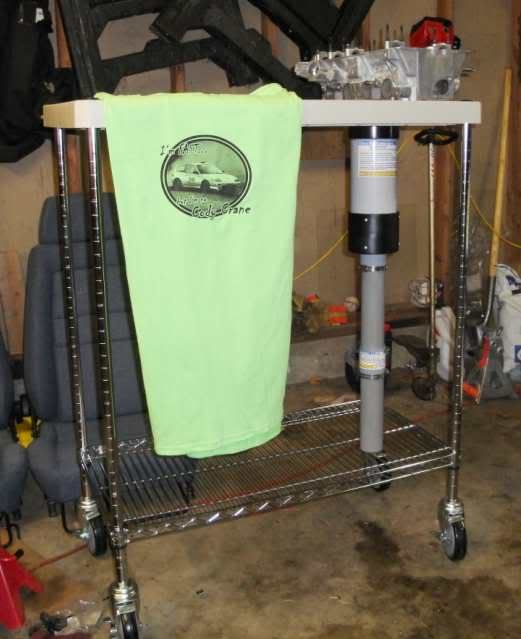

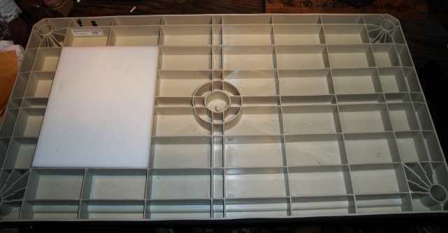

    A friend and I went out today and did some shopping/buying..... We ended up utilizing baker rack components. This is it in its first mock up. The flowbench parts are there for basic placement only... nothing as yet is installed.
    The plan as of now is to affix the large tube to the white melamine undersheet. The concave top will get a shaped to fit top piece of melamine with the bore adapter going through all pieces, and hardware holding all 5 layers (melamine plate with tube, rubber layer, table layer, rubber layer, melamine top layer)
    This design will allow me to have this portible and even collapsible!!

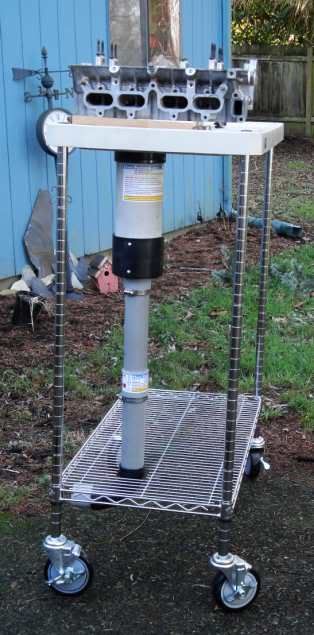

    Today....

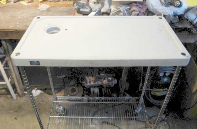

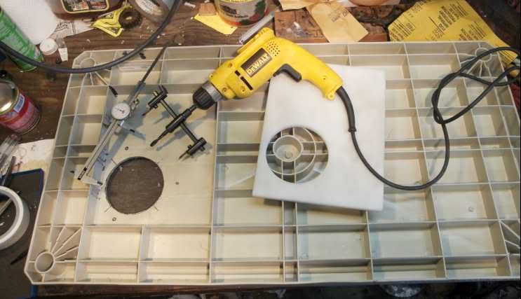

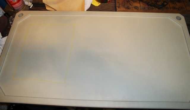

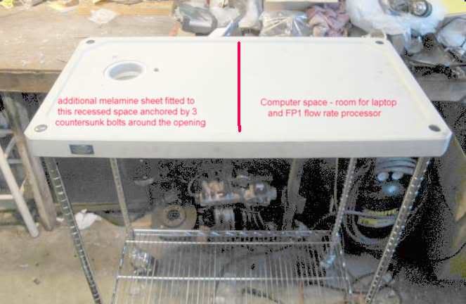

    I went and bought a hole cutter, and placed the flowbench off center this will allow me a bit more stability if I choose to do a straight 6 head (JZ anyone )
    As well as allows me to keep the strength of the lower rack by NOT having to remove the main structural cross bar seen under the finished table top below
    There is still the bore adapter(seen in the 1st photo, of the 1st post - upper right/center) to consider and I have a plan for that, and future bore adapters.
    I will have additional 1/2" plastic cutting board sections cut to fit the particular shape of the table top (note the cropped corners) Each new bore adapter will get a new 1/2" sheet.
    Here is my "finished", fully portable(wheeled, as well as under 60#s), and collapsible flowbench
    Now I have to find a reversible 5hp shop vac
