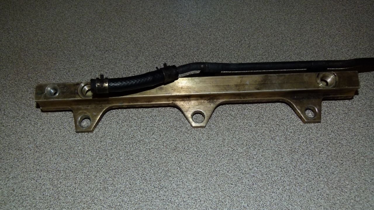

				Hi again, this is a follow up question to my one earlier regarding the Walbro pump and regulator. You see in that thread it was pointed out I'd need to do something with the fuel rail.
Well today I set about removing my rail, to have it machined. Funny thing though - I remove my throttle body and see a top feed rail, from a ST165 by the looks of it. Someone, somewhere along the line, has converted my set up to use that top feed rail.

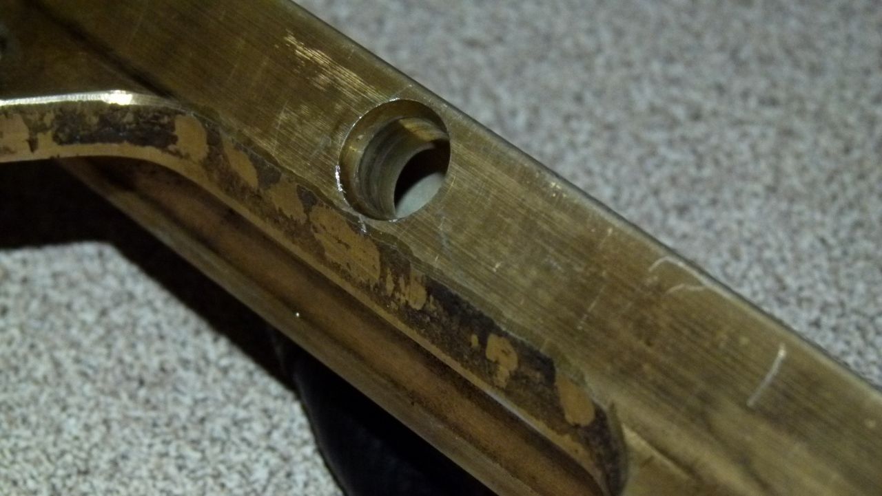

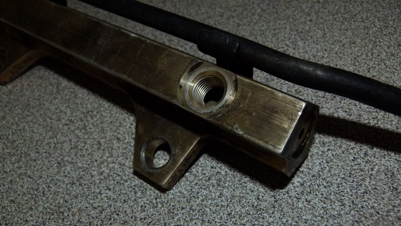

I have taken some pictures, by the look of it, the bore in the centre is continuous, and quite a lot larger than the 4mm the ST185 ones apparently are.
Basically, I'm asking whether this will flow ok with the Walbro, Turbosmart Regulator, and later on down the performance road, bigger injectors?
Thanks again!
Nick

				but yes the gen1 fuel rail will flow fine for the walbro pump, toyota should've kept top feed rail for all gte's but they didn't
