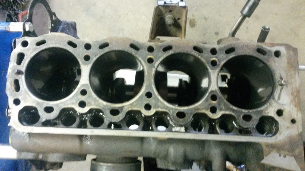

    Pic shamelessly stolen from Tore's ride thread
    2TGEU block with lifter bore holes evident. Again pic stolen from Tore's ride thread. I can check my 3TGTE block to see if the lifter bores are machined when I get a chance.
