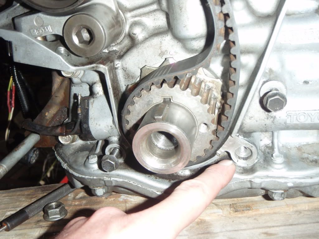

Hi all,
I need to get some information about this part on my ex-Aristo 2JZ before i re-install balancer etc....I have looked through Toyodiy with no luck. First pic below is from the Toyota 2JZ engine manual.
It looks to be some type of timing belt limiting tab or something, this previously dis-assembled engine did not have it, so im trying to chase it up before refitting all the external bottom end stuff...
Even a picture of a 1/2J with the balancer and bottom timing cover removed would be invaluable to see whether making something would suffice??
Appreciate anyones help!
Cheers!
-Dan

Yeh thats exactly what it is, ill have a look on toyodiy for a partnumber but its probly easier to ask in the wanted section too
It is what you think, just a tag to hold the timing belt onto the pulley.
It is just a rounded oval shaped tab that holds it to the pulley just enough so it doesnt jump when you have the belt off.
I would just leave it off, it does fuckall anyway
Thanks a lot guys!
Sooo, i guess the other question is, will I get away without it then???
Its not too much if you want to make sure you wont have any issues, about $4 total from Amayama
11324-46030 and 91631-60616 for the bolt (PN were with the oil pump if you want to look again - ToyoDIY.com )
Thank a million big-zop, totally missed the part number in Toyodiy.
Appreciate the help mate!!
if came from the factory with it there. just put it back on. It wouldnt have been there for no reason
Interestingly, the part numbers between the Supra and Aristo are different for whatever reason?? Supra one is $2.40, the Aristo one $8 something... Got the Aristo one, perhaps i should've also got the Supra one just in case... hmm
^^^ Disregard this, its the same part, just different numbers. (superseded i guess)
