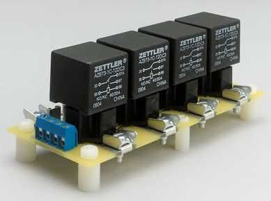

    If I may....... I went down this road with my AE71 build... partly because old wiring can lead to problems, but also old, and odd relays (or other electrical components) are expensive and often nearly impossible to get.
    I went with something called an EZ mini 20 harness (Wiring Harness). There is one big problem with these types of harnesses... no relays! So, a relay block(4) was added.
    and I used a plastic cutting board as the new electric mounting for the fusebox, and relays
