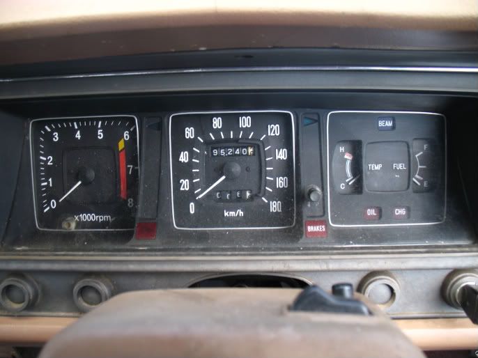

    Just find a taco from a early 70's Datsun 6 (Cedric Skyline etc)..... Most models came with a factory taco unlke the toyotas and are very close if not spot on for the size.
    My early GX10 has the square type dash, and with the mx13 having round ones your best bet may be a 240K skyline....... piece of piss to fix and will look factory

    Mate, that looks friggin awesome. I'll have to see if I can source a round one that will do the job.

    T130 series corona
    outa case near screws straight on. Just have to re-wire and cut/grind a small amount from the top plastic section for the steering column. oh, and re-wire headlights switch from the dash to the indicator arm.

    I just managed to snatch a 240z tacho off eBay. Looks like it's gonna do the job, fingers crossed for when it turns up.

    Like the above one?
    Just ask the bloke selling to measure the diameter and length, i cant remember where they sat in the old zed's.... should be right though.
    you may need to mod it a little, should look good, best of luck with it mate.

    Nice one, that looks like it.
    I've got the measurements, but they are a little approximate. I'll have to pull it out of the casing anyway, so I guess it's going to be a bit of suck it and see. The diameter and style seem pretty good at least.
