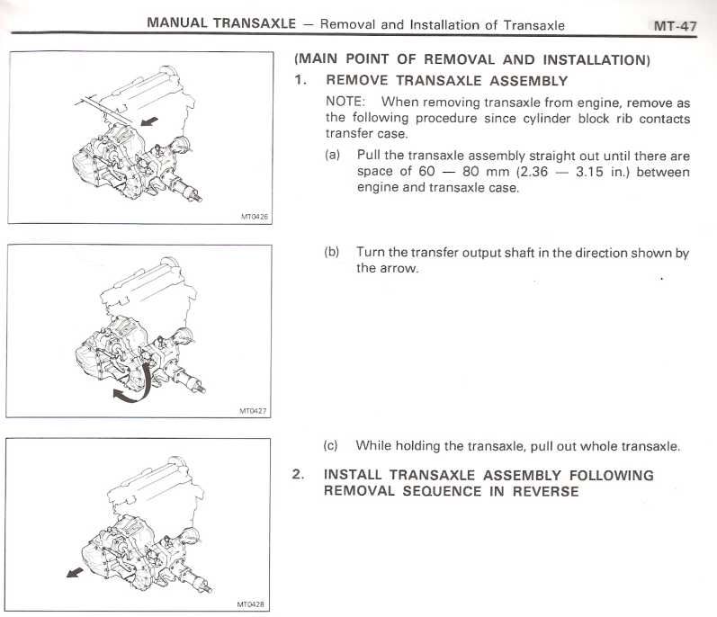

    Default Re: AE95 Question
    clutch is a 9 hour(what the book pays) job!!!
    To do the clutch in an AE95 you need to drop the drivetrain down, and then you need to lift the eng/trans up and unbolt it, then pop it off the dowels, rotate about 30 degrees to clear the diff from the block
