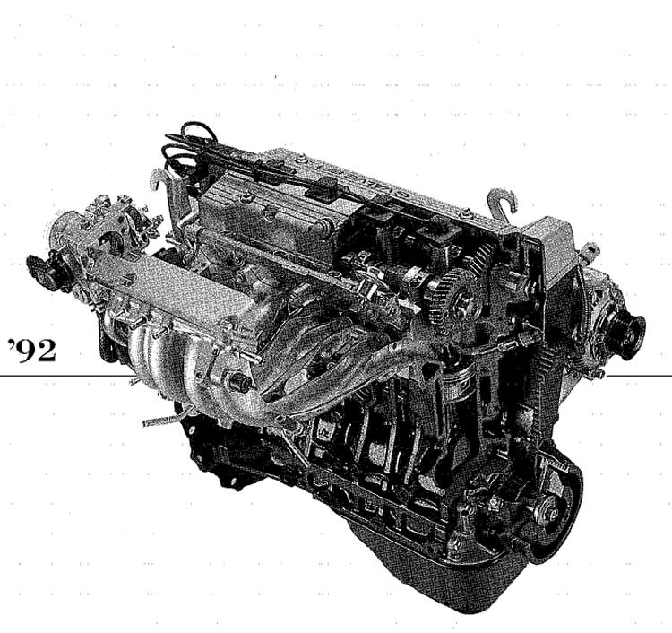

    I have dug up another press kit, this one is about the lean burn A series engine.
    It has OCR, so anyone can do copy paste and use machine translation.
    (The press kit is Japanese)
    www.3sgte.com/1992EngPressOCRa.pdf
    Machine Translation:
    http://www.excite.co.jp/world/english/
