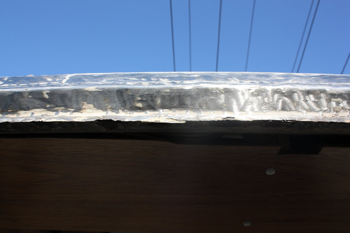

Joel, you can cut those rusted weak parts out. Use a 1mm cutting blade on an angle grinder for the cuts and use a spot weld remover drill bit. The replacement strips of metal should have a few of holes drilled into it. When the metal is in place, you then fill these holes with weld effectively creating a spot weld replacement. Any uneven edge here where the screen seal goes can be a potential leakage point.
Alternately you could use a decent rust converter, prime and paint, and ensiure there is a shitload of sealant pumped in under the windscreen seal. Just remember these thin areas will be weak as piss, and could move around a lot when putting the screen in.
