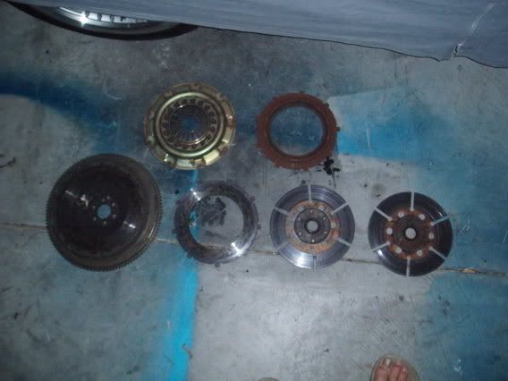

    The flywheel could also be of a 22R-E, but it's missing the ring gear? Here is a picture of the one I took out of PHOBIA last year? Looks similar, if you want to measure yours, I can check for you?

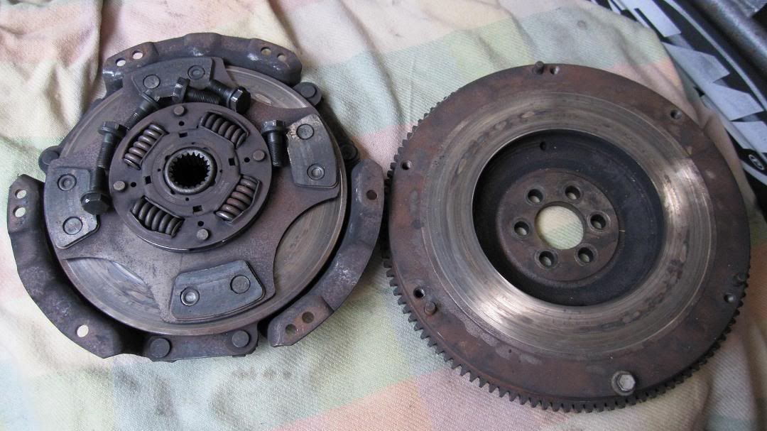

    On the 240mm 7MGE flywheel the ring gear is hidden / behind the front flywheel face. On the 225mm M series flywheel you can see the ring gear tho...!
    5ME on left, 7MGE on right

    heys pics of my 1g w58 combo to compare, no fly wheel pics though.
    and a 1g twin plate with flywheel, shithouse pic though.
