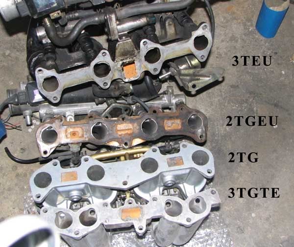

    Off the top of my head and without access to a picture of the port and bolt spacing, I'd say it may not be a bolt on. There is a couple of threads on here that have pics of each T series manfold that I also cannot see on this PC.
    If the port and bolt spacing/pattern is the same as 2T-G then yes it is easy. On a stock 3T-GTE it will run poorly as Jason mentioned as low compression will mean no low or mid range, but a pair of 40mm Solex/Mikuni can be jetted down with #28 Outer Venturies and will make the motor drive enough to get by.
    Compression it up, add cams and run twin 40mm Solex and it would be great.
    If port and bolt pattern not the same then a bit of work is needed to match it all up and then same as the above paragraph.

    Well if a picture speaks a thousand words then I only need Frosty's first paragraph to tell you there will be quite a bit of custom fabrication involved to make this work!
    Jason
