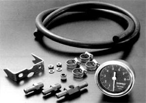

    This is the kit it self
    [Gentlemen's Club]
    3,468
    Default Re: Fuel Pressure Gauge
    Engine bay for that, best not to have fuel going to the inside of the car!

    that one is defently for the engine bay
    Perth, WA
    442
    The set that shown in your photo (mechanical fuel pressure guage) is definately should stay in engine bay...
    You better get a set of Electronics Fuel pressure guage that can lives safely in your cabin :-)

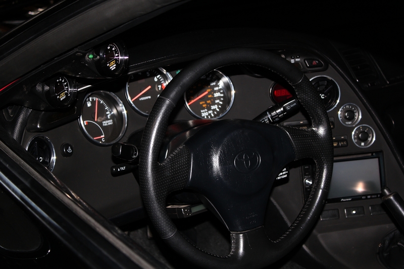

    I use a Cyberdyne electronic FP gauge in my MKIV. It's a cheap alternative and serves it's purpose well as a safe/accurate indash display. I tested it against a handheld shop tester and got the same results with both gauges. One thing I dont like ... The red leds are a little too bright , even with the headlight activated dimmer.
    Mounted in clock location for now.
