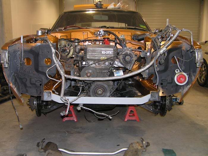

    If you remove the metal that the stock radiator bolts too from both sides it gives a opening of a bit over 600mm. It all comes down to if you want to cut up the front of your car to make it fit
    Heres the opening in mine
    1977 RA28 Celica 1JZGTEClick Me
    1980 Chrysler Sigma

    The GA70 Radiator upgrade works really well and fits nicely. I assume the MA70 Radiator is very similar ?
    Here is the standard Rad opening:
    And heres a shot with the GA70 Rad in place. You can see that the radiator support panel has been opened back to the factory fold in the panel on both sides
    The botton rubber mounts dropped into a length of 90 deg alloy angle. The top mounts were just the standard toyota ones bolted onto the top of the rad support panle and releived heavily accross the top to stop them rubbing on the bonnet.
