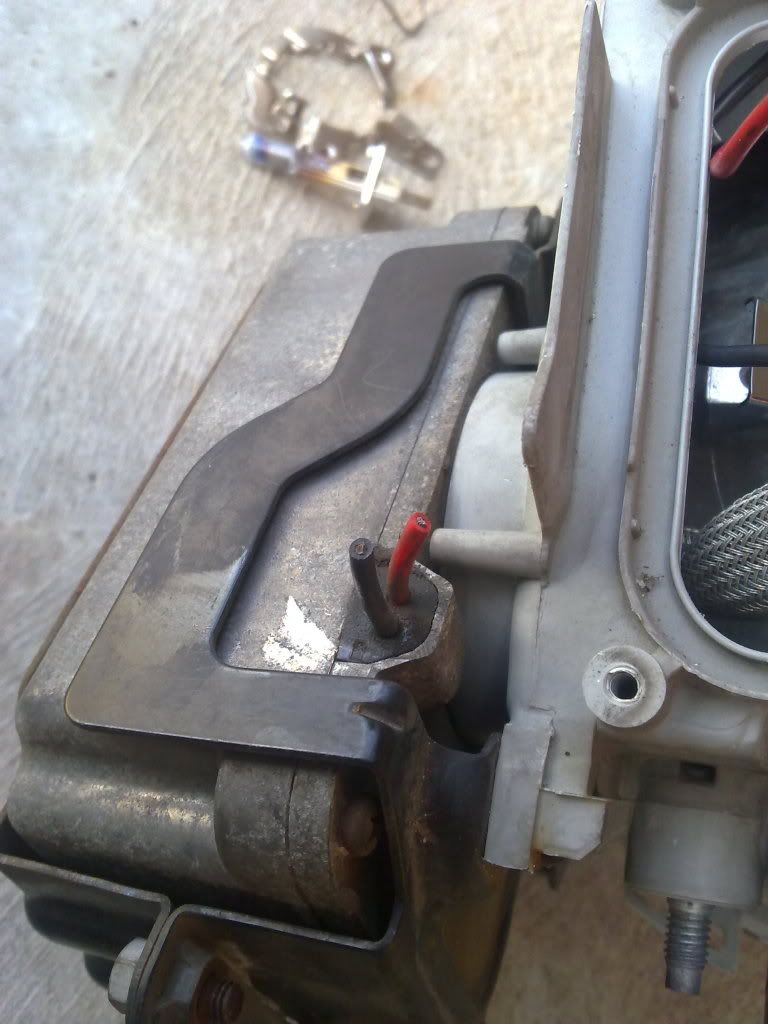

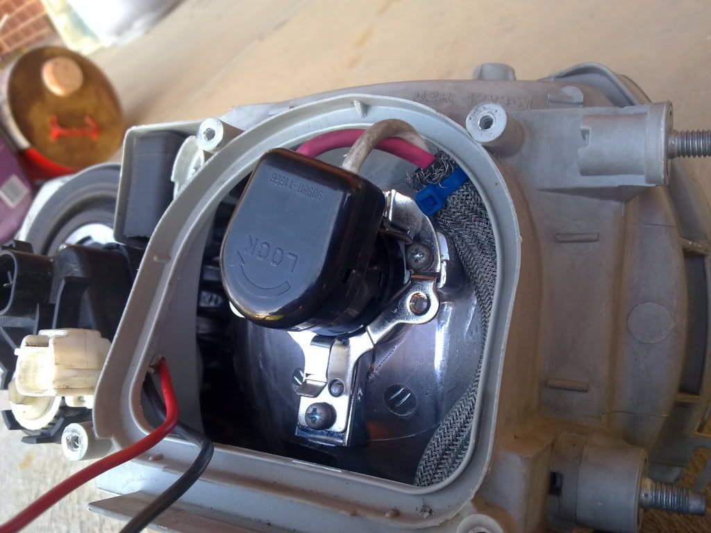

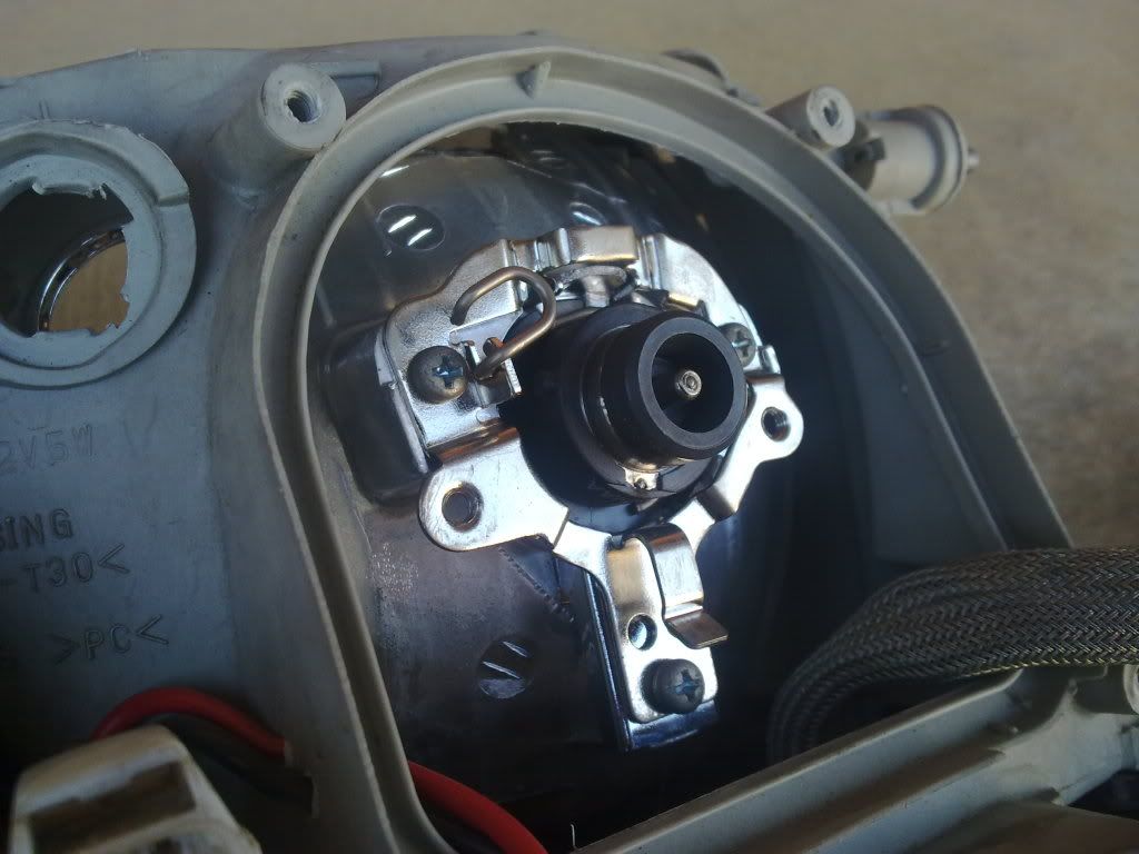

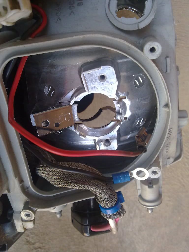

    I bought D2R 6000k's of ebay bout a year ago to replace the compliance setup that was fitted to my car, they are still going strong.
    My car was factory HID, and the workshop just fitted some H1 with an adaptor to get it through complience. you can see in the pics where they cut the factory wiring thankfully they tucked the D2R factory plugs inside the headlight assembly!
    Took me a bit of messing about to get it back to factory, but its been working fine for over 12months now.
    here are some random pics that might help, or could be a total waste of time. But there is some reference either way.
    Please visit here, they will have all the answers you need for this "conversion" - www.hot4s.com.au

    pics of removing the indicator showing the long clips that hold it in at the rear
