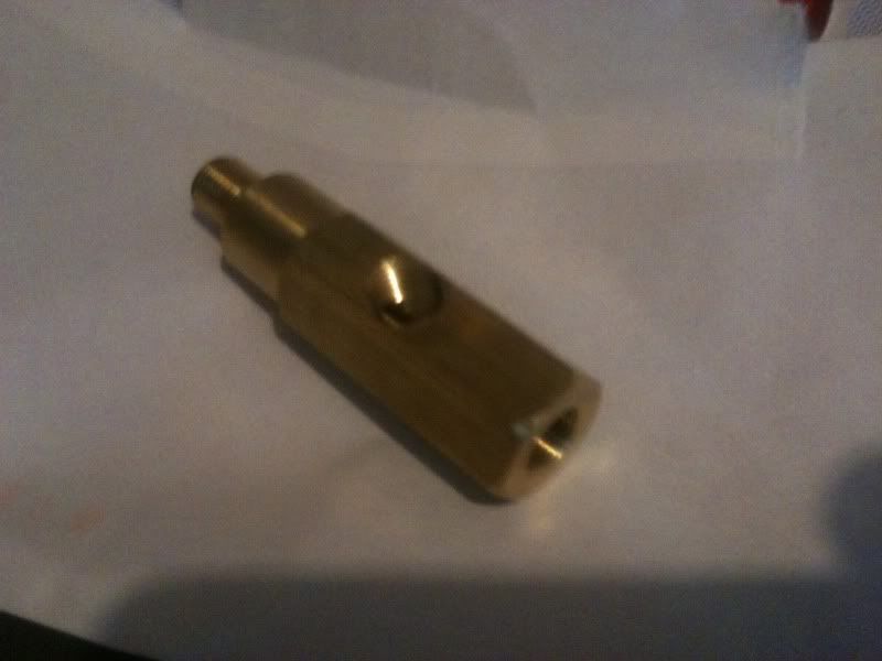

    Hmmm i see, and all valid points. The temp sensor does have a probe at the end but it would be sitting in "static" oil. Maybe a stupid question but would the oil sitting in the fitting not merge with the flowing oil and come up to the same temperature? This is the fitting i have in mind....

    Oil is thicker than water, and doesn't have as good heat transfer properties, so its more likely that there will be temperature gradients in different parts. The pressure sender is effectively a dead end, so the oil there will stay there, and only be heated by the nearby oil flowing past. This means it will be colder than the average oil temp, and delayed to any sudden increases.
    The tapped sump plugs look like a neat solution.
