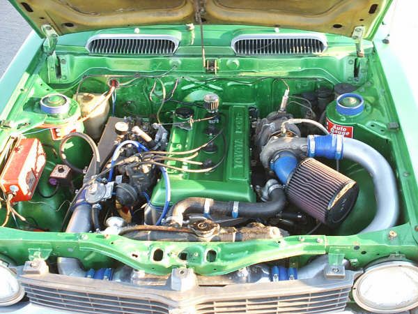

    not an 18RG but my 2TG
    Garrett-AiResearch T3 with A/R 48 turbine, 43mm wastegate, 3T-GTEU oilpump, decompressed 2T-G pistons, rebuilt bottom end, TE71 Mikuni's with bigger jets, EFI high pressure fuelpump, Malpassi fuel pressure regulator, custom intake plenum, front mount intercooler, rare longneck distributor, MSD 6AL, Blaster 2 coil, T50 gearbox, 3T-GTEU flywheel, diff conversion to TE71 T293 6.7" lsd.
    750kg, 210rwhp at 1 bar. 260rwhp at 1.6 bar.
  9. #1059
    Mar 2008
    490
    Default Re: The 18R-GTE reference manual ...
    I have nothing constructive to say, but that is awesome mate! I imagine it is ridiculous fun to drive

    Ehh.. 750 kg with turbo 2T-G?? How it is lightened?
    sorry the weight is just guessed by the previous owner so im not sure its a ke20 so It weighs original 780 kg.

    This is Bad-_ss!!! Very nice indeed!!! No heat shield for the Brake system? No problems?
