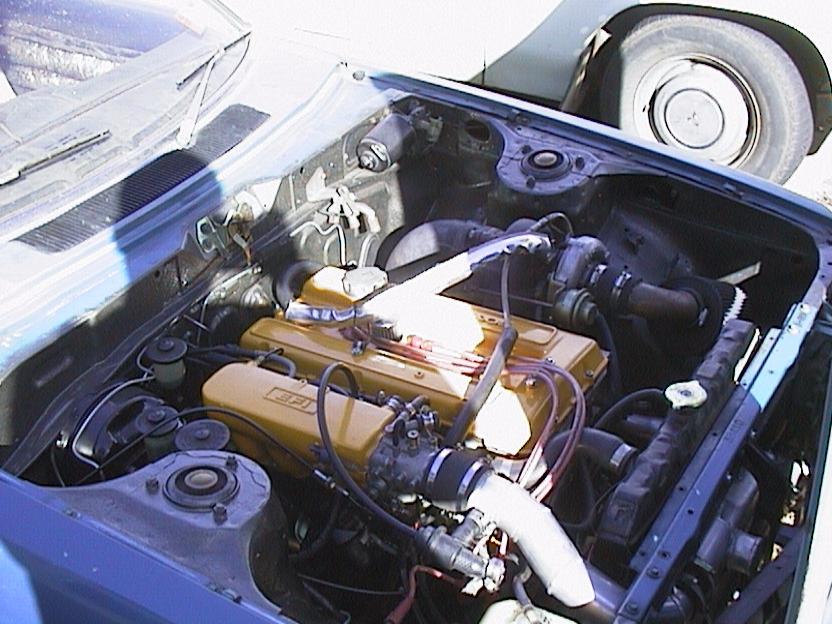

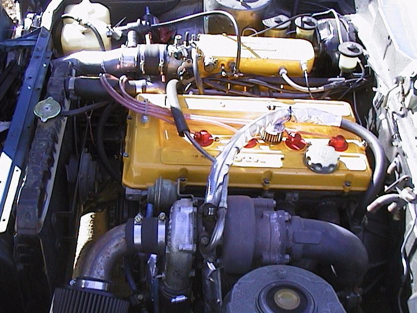

    I used ARIAS pistons but these days any of the brands that do an off the shelf would do. The stock HG is very good so i think just a set of head studs would cure that prob...it was the stretching stock head bolts that caused the problem. If you want to be real sure a steel HG is the only way to go. A copper one would also do can can be prone to fluid leaks if everything is 100% spot on.
    The car was totally streetable. I could plod thru corners in 3rd if i was feeling lazy or run 250kph down the Parkway if i was feeling like a rush. It was a bit of an animal in the wet but what do you expect for a big hp 4cyl
    Junior Member Grease Monkey Turbo RG's Avatar
    Pinole CA
    53
    Default Re: The 18R-GTE reference manual ...
    Jeez guys if those comments didn't sound likie you were referring to that old hermit on the hill i'd feel all gushy :-)
    As far as i know i had the 1st serious EFI turbo 18RG but Oz is a big place so not making any claims. It was serious where it needed to be so forgies, well sorted (but stock) bottom end, light billet flywheel, bigish cams, TRD oil pump, big sump, stock HG.
    Would take 18psi and 8000rpm all day. Up the boost to 22psi and after a wee while (6 months) you'd be looking at a BHG as the stock head bolts would stretch. All it really needed was a set of ARP head studs which weren't available at the time. On a coupla of occasions it 'accidentally' saw 30psi and didn't even blink...however, i shat myself as the rears dissolved in tyre smoke.
    Used to run high twelves around the old Wakefield Park circuit so possibly good for 10's on the current circuit. Best 1/4 time was 12.8@112mph with the stiff circuit suspension...soften the rear and a 12.5 is more likely.
    Anyways a great engine that only gave me HG probs because of my greed for boost.
    If i did it again the changes i would make would be minimal. Higher comp ratio, i would run 9:1, arp head studs, a fancier ECU and of course one of the newer tech turbos. 400hp flywheel would be a walk in the park.
