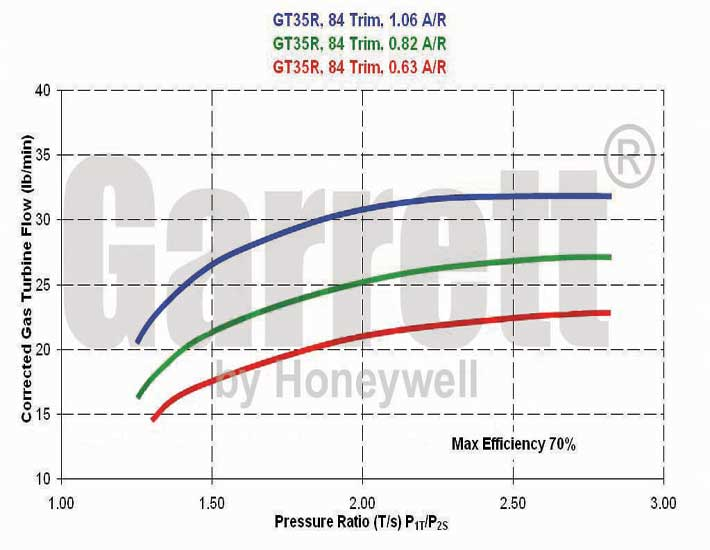

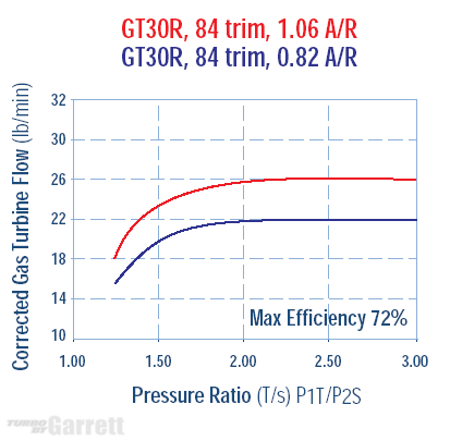

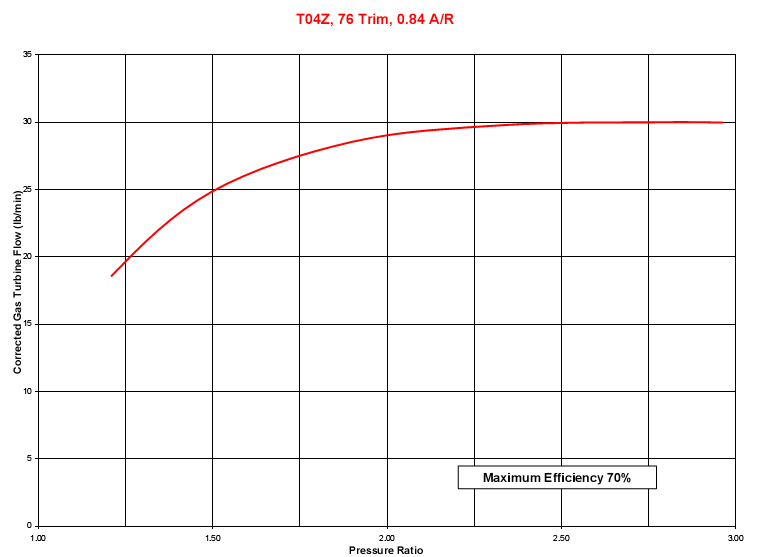

    In choosing the turbo I'd consider for my 1jz (single turbo + vvti), been doing some research.
    Wanted to get some feedback whether I'm reading into this correctly- like the to4z shows 30 lb/min @ 70% efficiency and gt30r 1.06 shows 26 lb/min @ 72% - I understand what you've mentioned, but looking at those figures I cant help but wonder wouldn't they more or less be same in response / drive ?
    Mind you I haven't been in cares with any of these turbos, purely going by these plots (so easy on the flaming ) -
    advice?

    Not silly, but it's not very clear what you're trying to ask?
    Default Re: Turbo flow comparison GT35r , T04z, GT30r
    Quote Originally Posted by jdm93 View Post
    the plots just show you maximum airflow at that efficiency, at a given pressure ratio.
    doesn't really show you anything abotu the efficiency at other pressure ratios/airflow (ie you need the proper compressor maps)
    neither will show you spool time, which will affect the driveability

    that !! - hmmm so with that in mind something like this on a 1j would be lag ++ ??
