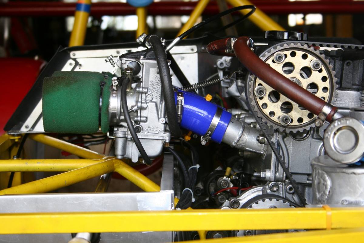

    1,427
    Default Re: anyone put motorbike carbs on a car engine?
    Yep, on my racing car.
    Three main things you have to -
    - Run near-zero fuel pressure. I run a conventional small fuel pump and on top of each carby there's a t-piece, then on the last t-piece the return line goes back to the fuel tank but it's longer than the line to the carbies so it makes a touch of backpressure that way, and that's all the pressure I run.
    - They have to sit upright, they don't like sitting at an angle or they will run out of fuel around a left or right corner. In the photo below you can see the rubber pipe I used to get them to sit vertically. Note that some bike carbies are built to run at an angle, but again they should still be run at that same angle.
    - Mine at Mikuni flat-slides and to work properly with a car engine we had to get power jets added to keep the mixtures right over a wide rev range. It's an easily available kit and not too hard to fit.

    <off-topic>
    Bill - I couldn't help noticing that your adjustable cam gears are not anodised in bright blue/pink. I was under the impression that the lurid colour was required for them to work properly ?
    At least the inlet plumbing is a bright enough colour.
    </off-topic>
    I assume the engine is longitudinal mounted in a clubman or similar ?
    Nice point about fuel pressure - I'd forgotten that bike carbs are gravity fed. Also most bike setups have the carbies rubber-mounted like yours - I assume for vibration isolation.

    thanks for that billzilla that was exactly the information i needed and the pictures were perfect, thats EXACTLY what i wanna do... how does it go? rev? and torque wise?.. compared to if you would of say bolted two big webbers on there?
