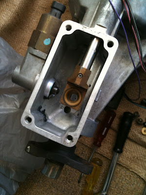

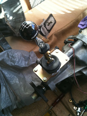

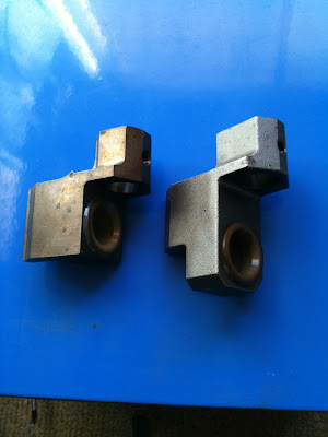

    Had a question about the shift lever. This is needed to fit the Camaro shifter to the Commodore box, here are some pics outlining why, the Camaro lever is the shorter one:
    Without the lever, you won't be able to select every gear as the pivot point is wrong.
    Nathan
