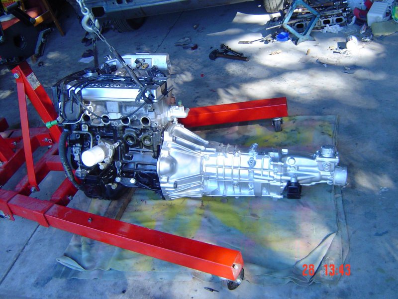

    Hi. I tried to attach photo, which after altering file type worked.
    Looks like a separate bell housing to me and gear lever is at front of rear housing, same as TA22.Attachment 10458

    is it a cable or hydraulic bellhousing?
    can take pic of other side of gearbox?

    Hi oldcorollas. I got a message from the seller saying it is a one piece gearbox/ bell housing and came from a KE series, even though photo looks different to one piece housings I dealt with before.
    Sorry didn't ask if hydraulic or cable clutch.
    Thanks again. ToyTA22

    this is T50 box http://www.rollaclub.com/faq/images/...1117457073.jpg
    this is K50 http://www.toycrazy.net/mark/pics/ke26-3kswap-001.jpg
    Kseries boxes have aflat plate that bolts up underneath
    that pic you showed is a T series and all T series have detachable bellhousings, as does the one in your pic (i am 95% sure)
    ask seller if it is for hydraulic or cable clutch, or get them to send pic of the other side
    anyway, if it is na original cable clutch T50, then you cna use with T series BH, as the original ones were leftovers from the celica anyway.. apparently..
    edit: did they send you the wrong picture?
