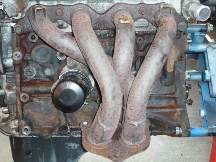

This is a shot of stock blacktop manifold :
There's not a lot of weight to be saved.

Improvements can be had by replacing the secondary pipe (goes under the engine between the pipes shown above and the cat) with a larger diameter custom piece. The stock pipe is very restrictive.
