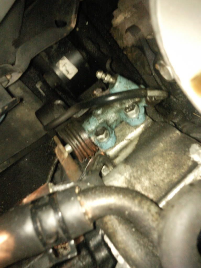

    Thought id update this, as i now have a photo of the slave cylinder.. hopefully this is the prob, not the plate itself..
    give your thoughts
    rebuild the slave or replace it?? what models have this type??

    I would try replacing the slave cylinder first. They normally are not worth repairing because they rust internally and get holes where the rubber seals run so the new seals will also leak. You are supposed to bleed your old fluid out and replace it with new fluid every 12 months or so to stop this sort of thing happening because brake and clutch fluid absorbs moisture which causes the rust.

    Quote Originally Posted by TRDcelica90 View Post
    give your thoughts
    What problem, it's a pic of a slave cyl. with a very compressed dust boot, that's all. To me, it indicates that the clutch is well worn & pushing the slave's piston near the bottom of its travel. The slave will either work or leak some while it still works or leak so much it doesn't work.
    You haven't written anything about any problem that would suggest its cause is from the slave.
    Adjust the pedal height.
    Adjust the clutch MC free play.
