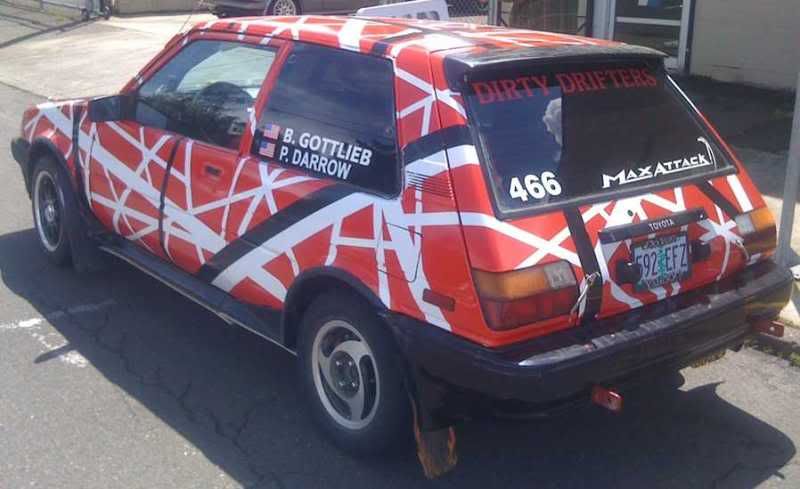

    I've recently been drawn into(can you say suckered??) a rally team. I'm "acting" tech specialist (ok, when you stop laughing, I'd like your focus.......)
    We are an AE82 3 door(known in the USA as the Corolla FX16), running with a "mild" performance largeport engine (rated 134hp@ the wheels @ 7900 rpm.
    Here's a recent video of us on stage
    http://www.youtube.com/watch?v=VownGhjOdC0
    Our main issue right now is getting the suspension more suited for our needs. We are currently utilizing parts from Hot Bits in Canada(www.hotbits.org). The specifics I'm not yet fully aware of, but I can say that we blow through strut mounts on a regular basis. I will get more details, but what I'm really inquiring about is EXPERIENCE rallying these cars and what works!
    Do you have any fond memories of little sleep, and crew abuse? Well, I know those things.... now I'm hoping to learn something to make those memories a bit sweeter....
    WHAT DO YOU KNOW...............????????????

    Haven't done any rally (or any track event) at this stage in my life, but im building an ae92 with a pretty hot 4agte for tarmac rally
    I only know of a car that ran bilstien rally (dirt) coilovers with success, but the car has since been converted to tarmac and they were sold/given away or something. I can possibly put you in touch with the guy that now owns the car now, but i don't know how much he knows.
    Keen to know more about the car / more pics
    hope this helped a little kinda
