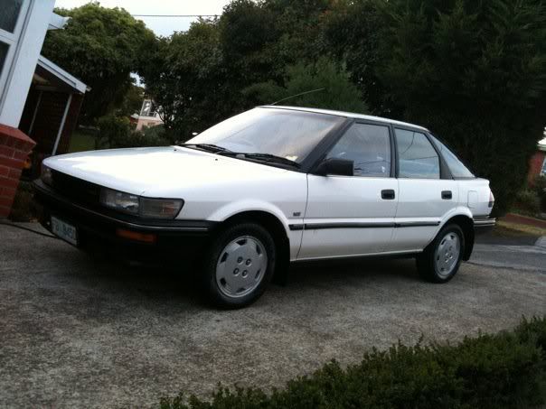

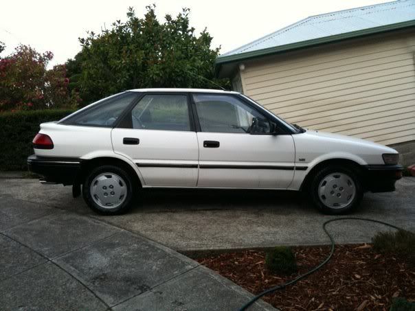

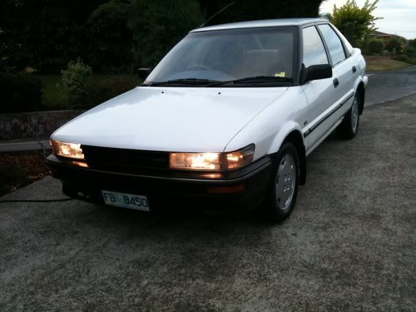

    Here's the car in question.. should hopefully have it in the coming weeks..
    Looking forward into making it a bit of a sleeper
