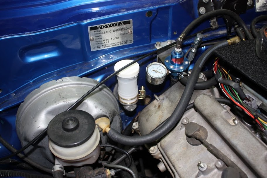

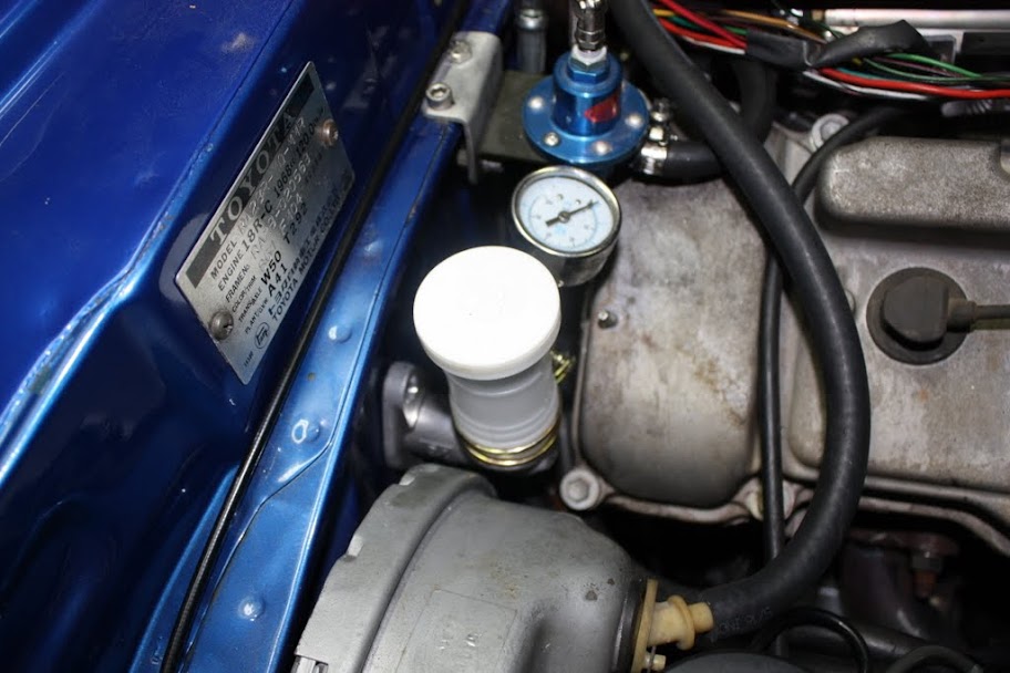

    1,917
    Default Re: 3/4' clutch master cylinder for RA28
    I fitted a NL Pajero clutch master cylinder tonight.. Worked a treat! Shorter than factory RA28 item which is good for clearance with engine.. 3/4" and only minimal mods to fit.
    The hole in the firewall had to be enlarged from 33mm to 35mm with a die grinder.
    The 2x bolt holes for the Pajero MS had to be elongated 2mm each.
    The Pajero uses a M12 thread where the RA28 had a M10.. So I am going to have to cut the flare off, fit new M12 bolt and re-flare.
    1996 FZJ80 Landcruiser.
