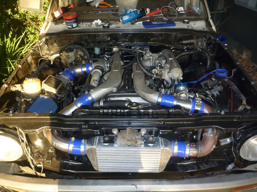

    dude i started with the same package as you did.. ended up with a 1ggte and the supra 5 speed. fits in mint wasn;'t really a expensive has i had thought.
    upgraded from all drum brakes to 4wheel disc's and mx83 master cylinder.
    upgraded to pwr steering.
    any questions just ask
