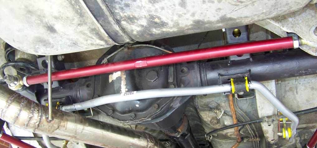

    heres one I prepared earlier

    ah very good, thanks, what swaybar did you use, skyline or off the donor vehicle?

    I have previously had it for the stock bars on the vehicle, but on this ae86 its a whiteline bar. The original and this ae86 ainti-roll bar fit very nicely.
    Also if note I used the ae86 hydro lines with the ends bent a bit, they fit really well. I love it when things look original.

    You may want to check the flaring on the hydro line. If I recall they are different between the caliper and the ae86 line. Toyota use a cup where as nissan use a ball, I just had mine re flared.
    I had a very quick look at the original sway bar and thought it hit hence I don't have one at the moment. I have to go back and have another look, your pictures suggest it fit but must be close, have you checked full range of movement? Would be great if it fits, means I don't have to go custom.
    Roger

    hmm interesting, I could of overlooked that one, that said though I have had no issues.
    I was also concerned about the anti-roll bars but yes they do have the full range of movement upon checking.
