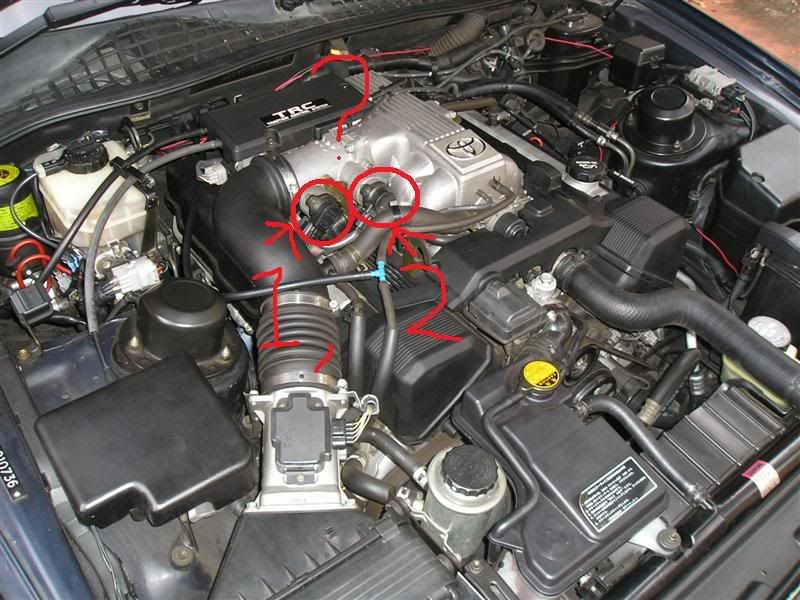

    ISCV is right on the front of the inlet manifold.
    2,724
    Default Re: celsior issues
    forgive my 1uz ignorance..
    but
    Stomps
    1,820
    1,2 are throttles
    ISCV is in front of the plenum right in the middle. Under toyota badge
    4,152
    Teehee Stomps. Front of the manifold relative to car
    1,820
    Also the hunting would be caused by the revs being too high with the tps in idle.
    Need to work out why the revs are going too high. Clamp the hose that comes off the ISCV and see if its being held open.
