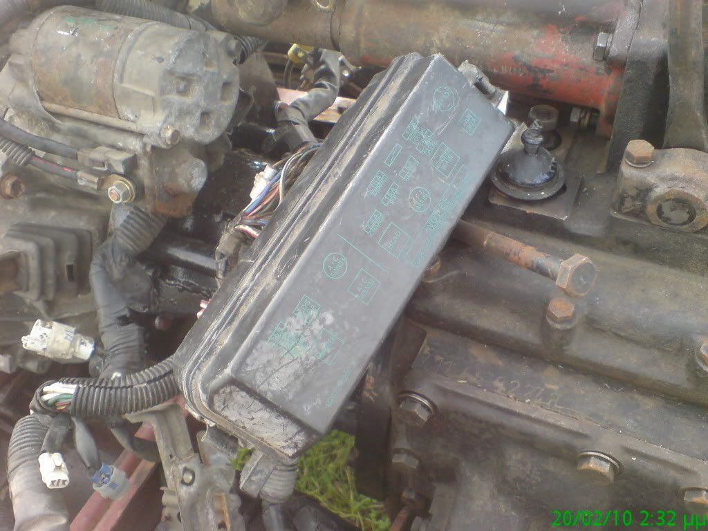

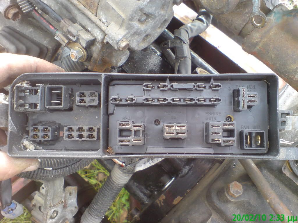

    Im trying to start a 3s-fe engine and i have a problem
    there are missing thinks that i dont know what they are
    can any one help me by :
    * telling me wich of them is important to start the engine ? or show me any picture of this box full
    ( i dont care about lights - turn lamps - glass cleaning & heater & other motors )

    "EFI" and "ENGINE MAIN" relays would be a good start.
    you will need a number of fuses as well. I guess you could put 5 or 10 amp in and see which ones make the relays work
    you could use a multimeter to see which fuses are connected to the relays.

    efi is a 15 amp fuse

    I'd just pop down to the wreckers and take the whole fusebox.
    Or grab all of the fuses/relays/fuse links from one
    There are heaps of wreckers around that will have camrys

    dont forget this guy is in greece in what appears to be a rural area.. but yes the engine main and toyota efi and corresponding fuses.

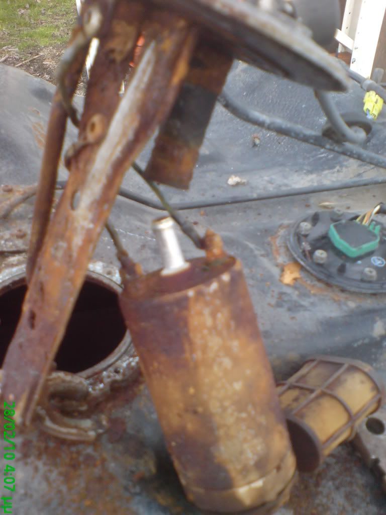

    Well the pump is rusty , i need a new one ,
    http://i605.photobucket.com/albums/t...o/DSC01885.jpg
    thats easy but...
    Somehow a plug is cutted , im trying to find the cable of the fuel pump and
    i need to know one information
    When the key is turned at ON (lock - ACC -ON - - Start) is the pump working for a few seconds ?
    If you know or you can test it by hear your camry please let me know

    My camry has never had any pump priming when switched to ON.
    If you still have the AFM (air flow meter) turn the key to ON then press the flap inside the AFM open and you should be able to hear the pump.
    you can use the pump from an st184/st185 celica, or vzv21 camry. if you have trouble finding one i can send you my one but postage might be a bit.
