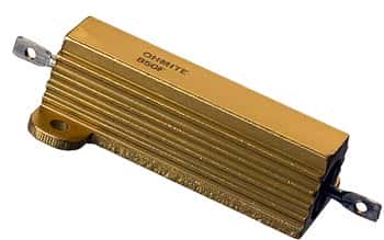

    yes, you can, but need to have beefy resistors.. the aluminium finned 15/25watt ones would be good
    many cars have injector resistors stock (esp toyota).. usually finned aluminium case between power and injector.

    i think the ones i have are "Ohmite" brand resistors.. didn't end up using them yet. need 1 for each injector. better to mount on flat alloy as a bigger heatsink

    It needs to be in series not across the plug of the injector
