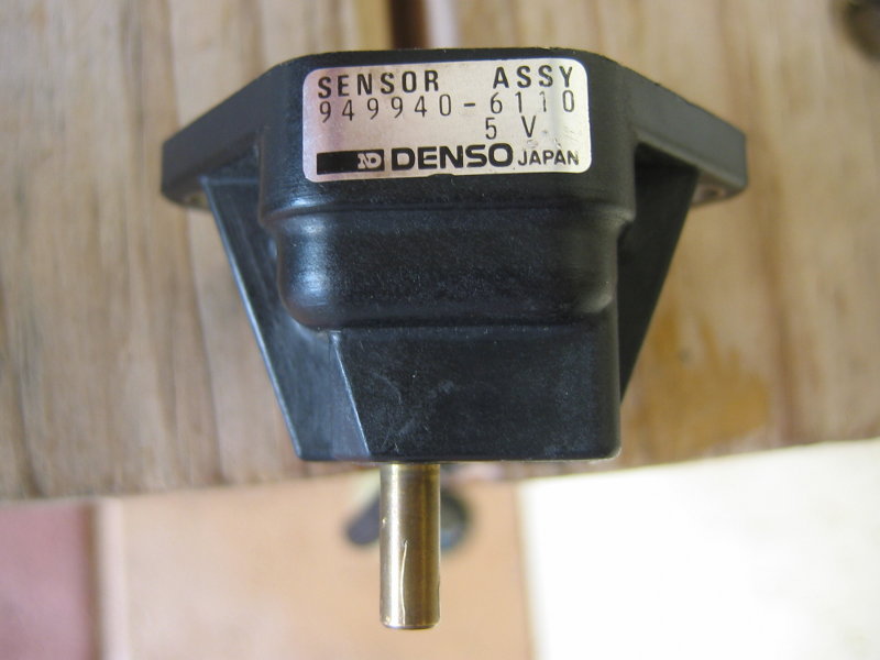

    I have a Denso 6110 MAP sensor that I'm trying to figure out which wire is power, ground and signal but I'm stuck with the colours.
    Any ideas?

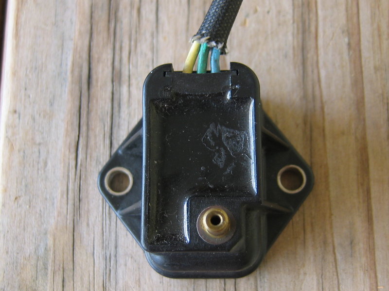

    Default Re: map sensor - which wire is which
    i believe green is usually the signal wire
    which would make sense with it being in the middle
    i have a denso map sensor here somewhere but cant find it.
    id give blue (-ve) yellow (+ve) and green signal a go but dont quote me if it fries it
