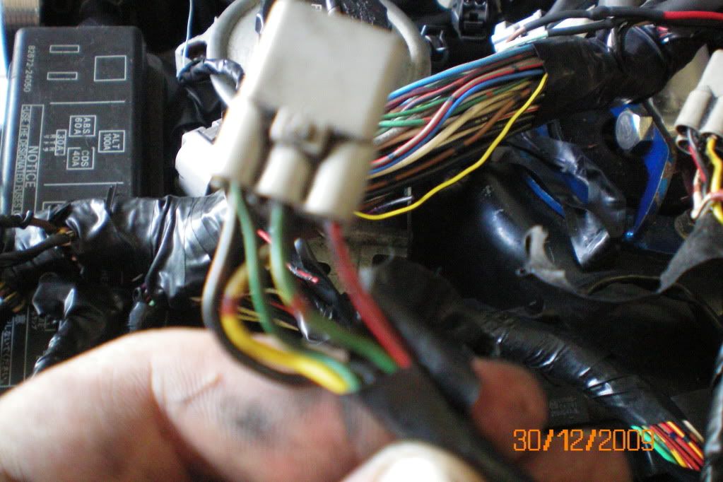

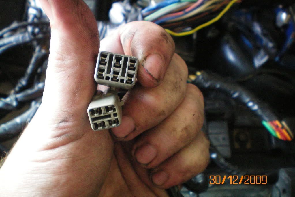

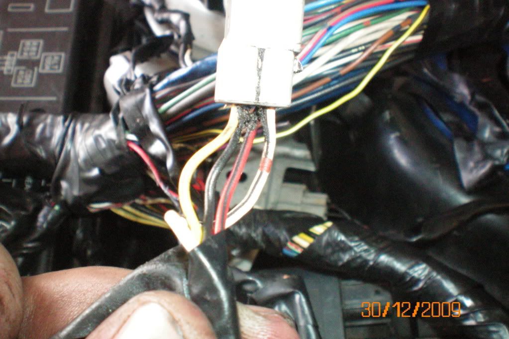

i have a couple of plugs on my jza70 auto loom i need help identifying:

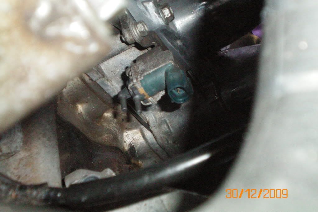

also this vacuum switch, what vacuum should be connected to it? it is located under the intake manifold:

Originally Posted by RAd28
That VSV is for the Charcoal canister. This is meant to be controlled by the ECU. Should be a plug for it.
Not the best pic below, but one side goes to plennum (via 1 way valve?) and the other to the charcoal canister if I recall off the top of my head.
yeah had a look at mates motor this arvo, i have deleted the charcoal cannister anyway
still cant figure out the other 2 plugs, must have been auto stuff
