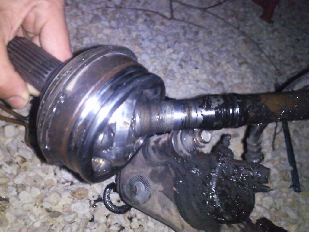

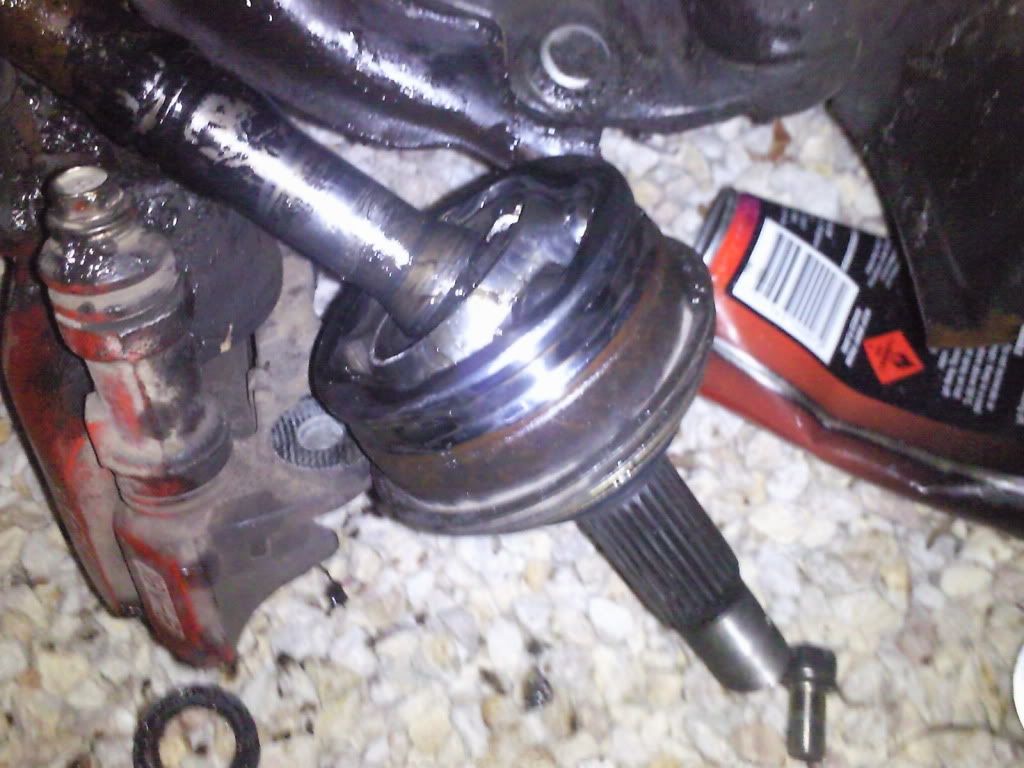

    Default Re: ae93 cv boot replacement
    This help?
    This is the outer joint
    I think if you hammer the inner "star" (the bit that is on the shaft itself) with the shaft in a vice it should come off, normally there is a C clip holding them on which is just has to slip past.
    Will probably take some pretty hard hits though, use an old extension or a punch or something to make sure you're only hitting the inner star
    When I do the boot on that end, I usually dissasemble the joint from the inner end and slide the boot on that way. The inner end's CV cup comes off a lot eaiser, then you match-mark the rose-joint to the shaft, remove the circlip and tap the rose-joint off the end of the shaft. I usually do both boots too.
