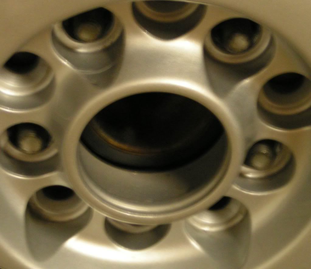

    Also, still on these wheels, I'm not sure if this is an issue or not, but I'd like some advice on what's best to do about it.

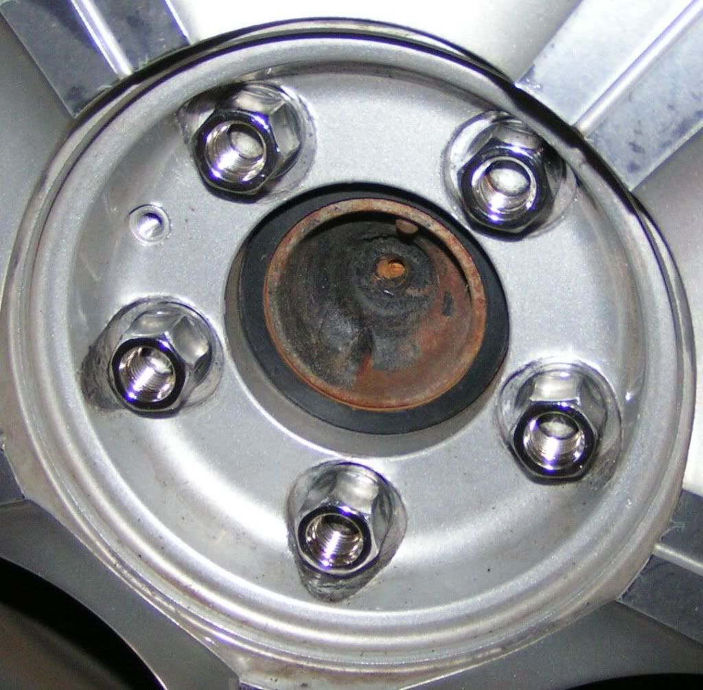

    In this pic you can see how the black sleeve fits perfectly with the inside of the current wheel.
    However, with this one you can see how there's about a 5mm gap between where the sleeve ends and where the centre of the wheel begins. As the wheel sits right now the centre of it is not touching the hub at all, although the rest of the rear of the wheel face is flush with the hub, and all the weight is going directly upon the studs. Will I be looking at some specially-made hub-centric spacers for these wheels to fit right or is there another simpler solution?

    Actually I think I may have figured out the issue with the wheels not mating up to the hub like the current ones do, I just needed a visual aid to understand how the wheel, spacer and hub fitted together.

    +15mm on the rears is about perfect to get the rears sitting right, gets them away from the struts but shouldn't go too close to the guards so that they rub there - with rolled guards you could probably go to +19/20 or so. Either way, it makes the rear end look a lot more natural, the stock offset tucks the rear wheels so far into the guards it isn't funny, which is strange because you'd expect the rear brake-hat style (with the handbrake in the hub) to push the wheels out further than a combined caliper/handbrake setup.
    And the spacers I've got on the rears at the moment have the 54.1mm locating lip for the wheel and a respective cutout on the rear to locate onto the lip on the hub, gives a nice tight and even fit that way.
