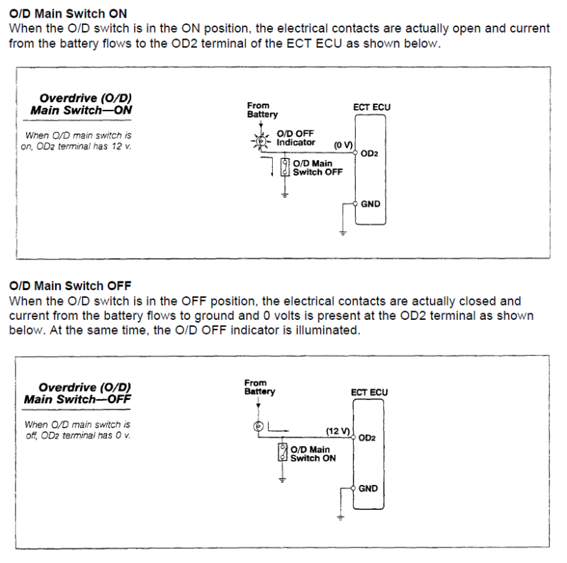

    Mine does the same thing with the overdrive. I havent looked into it enough yet.
    The tacho convertor is simple enough to make, I had enough random spares lying around to make mine out of bits!
    Herus
    Member's ride thread!
    Joined Team BHG, 19/7/2008
    Joined Team JZX83, 15/11/08
    3,468
    Default Re: tacho convertor and jzx83 overdrive problem
    As said tacho boosters are easy to make. Have a search.
    As for OD.
    http://www.autoshop101.com/forms/h16.pdf
