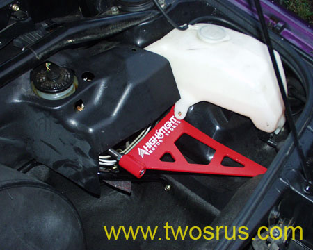

I have no photos but Commodores have them fitted as standard. The brace bolts into the end of the master cylinder and on to the inner guard. The brace is made out of some folded steel.
Not sure if there is a suitable threaded hole in the end of the xA6x master cylinder - I doubt it - so the other option might be to brace the booster using the studs that mount the master cylinder. You'll need to triangulate it to make it sturdy.
