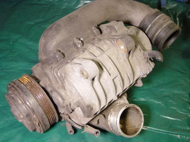

    This is the supercharger I can get; it came off from a chaser.
    The set up is going onto AE86 so I dont have any firewall problem.
    I have noticed that the pulley has place for sc belt.
    My questions are:
    Will I be able to mount that sc easier compare to sc14 from Previa?
    Will I still need to modify the charger pulley?
    I want to keep ABV and without shaving the intake manifold mount.

    that is the correct supercharger. do you have access to a set of sc12 manifolds? as that will help with the fabrication
