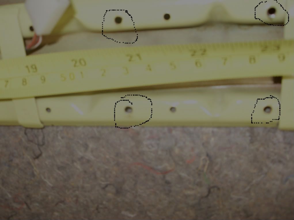

    I was wondering if someone could please measure the distance from the centre of a TA22 interior light to the door and to the edge of the windscreen for me please? I'm nursing one back to good health and the previous owner re lined the roof but didn't put the interior light in and i don't want to cut the roof lining in the wrong place to feel around for the wire.

    circled holes are the factory screw holes
    measurements taken from bare shell (no trims or chome strips)
    drivers side pinch weld to centre point as seen in photo 562mm
    centre windscreen pinch weld (front) to centre point of 4 screw holes 680mm
    keep tape mesure tight (dont push tape against roof lining)

    perfect, thanks heaps mate

    Why not use a pin to check for the holes, it won't be as damaging as a piece of wire?
