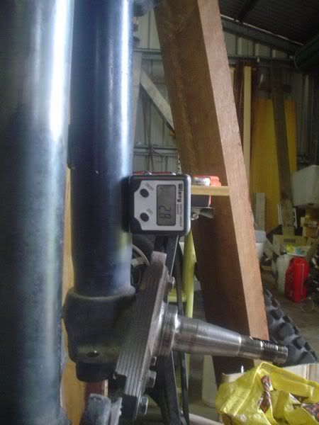

    pretty hard to measure, got any suggestions on how?
    can contribute xt130 and ae86 if so.
    Default Re: strut inclination angles info.
    assume strut tube is straight and mounting plate for callipers is very close to 90 degrees to king pin angle.
    wilbo's neat device has an arm coping out of it that measures angular difference between base of unit and arm
    attach to strut tube, place ruler across brake-caliper mounts, move arm of little device so it lays along (e.g. parallel to) face of ruler.
    3,468
    Actually my little box doesn't have an arm, it is only that little box
    Internally it has a little pendulm tho, and works in a very similar fashion to a set of digital verniers...
    All I have to do is
    >mount the strut so that it cannot move.
    >put digital inclinometer on brake bracket
    >zero digital inclinometer
    >put digital inclinometer on strut tube
    >digital inclinometer will now be reading angle!

    Just to resurrect this one, you can now get those digital inclinometers at Bunnings, and im off on a hunt for MX83 and MA61 KPI data, so i figure i may as well do other common struts while im at it.
    What other struts are people interested in?
