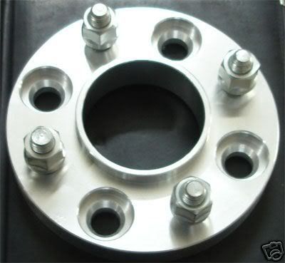

    Quote Originally Posted by Kedderz
    Hi Guys, currently on my ra23 celica im running a f series from a mx10 corona. It is unshortened which means I have to run fwd offset rims. Currently I have a set of Lenso wheels which a 17x7, +45 offset.
    buy a pair of these to combat +45 offset issue, on the front.....
    buy the 25mm thicknes not the 20mm ones, some grinding of studs will be necessary,
    (on the factory hub studs) the factory wheelnuts and studs always stick out past the new hub surface.
    the only other way is boring 4 holes in the rims for clearence

    Quote Originally Posted by frostyadonis
    Check the backface of the wheel before embarking on any stud shortening, as most wheels I have come across have voids where any studs would normally sit. Not too many rims out there with a true flat inner hub face.

    ^^^^^ these are already fitted to Kedderz car on the front so that the FWD wheels clear the mcpherson strut.
    Haven't yet seen your car in person since the rebuild Kedz, but from the photos you seeem to easily have at least 12mm to play with on the outside. The question is, why do you want to go narrower wheels? The Lensos already look a bit skinny on the rear with 7" rim & 215 tyre.
