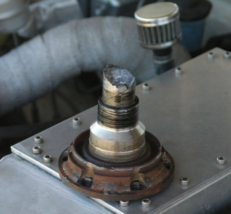

    Aaron did the slalom ok but when doing the burnout for the go to whoa he shifted into second then broke the mini axle in the hub. but he and Josh did a midnight stint and took the whole arm of his spare car saturday night and replaced the arm sunday morning. Aaron then did the motorkhana and had engine/flywheel issues so was out for the rest of the day.

    Some thing is NOT happy with the engine, only just got it tailored back home this morning.
    Almost cooked my ute on the way too :| ... Bloody heat.
    Here is the the result of snapping 2nd doing a skid...
    Yet to perform a post mortem on the motor...

    Yer it is still 'living' but making some horrible sounds & running like a dog
    The good part is my new diff cradle passed the thrash test, cooling, fuel & oil systems didn't miss a beat.
    Bout due for a re-build & forged bits.

    What you planning to strengthen the half-shafts again? I remember discussing it with you after you did it, but I have a memory like a goldfish sometimes.

    I am currently running the commodore 28 spline shafts & CV's (so far holding up ok)
    The only piece of the drive line which is still Toyota are the stub axles (Ms123 crown for 5 stud conversion)
    Now Im'e going to have to look at stronger options for the stubs.
    Prolly end up modding a commodore arm to suite the cradle & re-drilling the studs to suite my rims, this may be beneficial if I can get the offset right, wont require stupid huge spacers.
