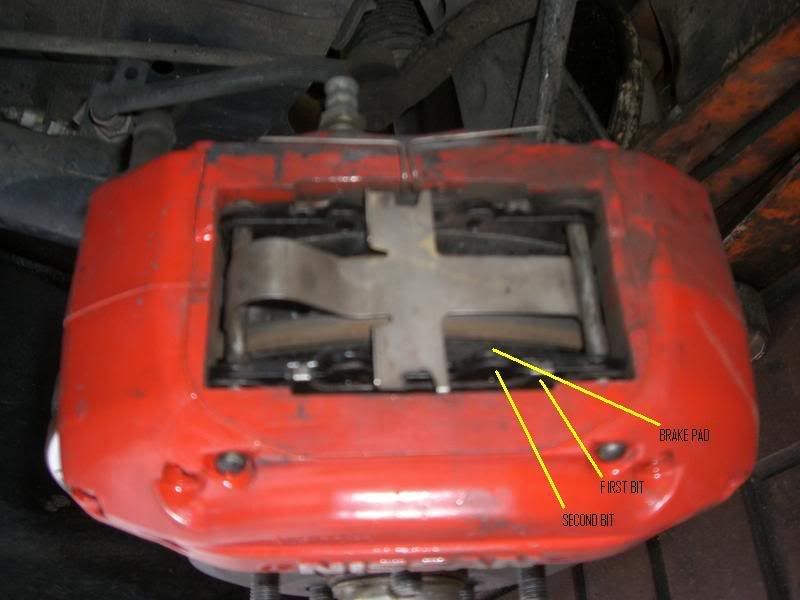

    40
    Default Re: brakes don't "bite"
    mine act exactly like Bungs, replaced pads no diff.
    I'm thinking because there is like two spaces between the pads & pistons, thats why the brakes don't bite until about 1/2 of the pedal travel
    like this pic

    Hmm, it could be the ratios (as you say) but the effect is actually the opposite to what you describe. If the master is too small, the pedal feels soft and has more travel but the bite/power is good (like using a long lever). If the master is too big, the pedal feels firm and there is less/no bite.
    The pads don't sound new, have you de-glazed them? It sounds as though the pads are the issue (providing the system is totally bled). Are the calipers on the right way up? The bleed screws should be towards the top.
    Being from a R33, the chances that the previous owner was a sikunt is quite high and therefore so are the chances that he/she has fitted super hard race style pads that don't work until they are nice and hot. Or, they may just be shit pads.
    For street use try some lucas/trw pads. They are cheap at around $60 and have great power/feel.
    Putting old pads on new discs is usually a bit of a mistake as they can cause funky disc wear. I'd be getting rid of the oldies asap.
