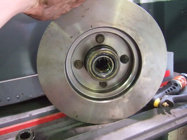

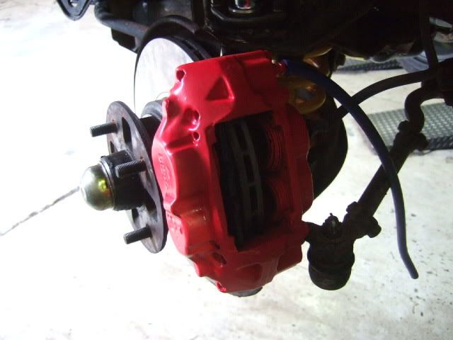

    Assuming they are the same as an MX13 (fairly safe bet) I was able to use 60 (80?) series Landcruiser calipers with Peugeot rotors (the ones everyone uses... 406 I think?)
    The steering arm or caliper will need to be ground down a couple of mm, and the holes on the rotors will need to be touched up with a round file, but otherwise this is a bolt-up conversion.

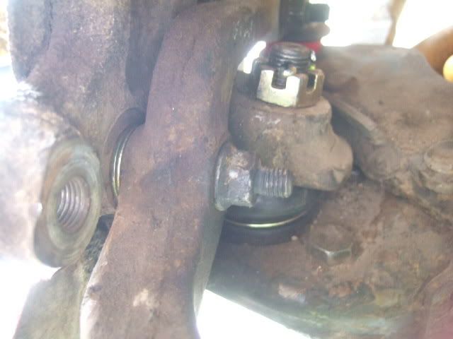

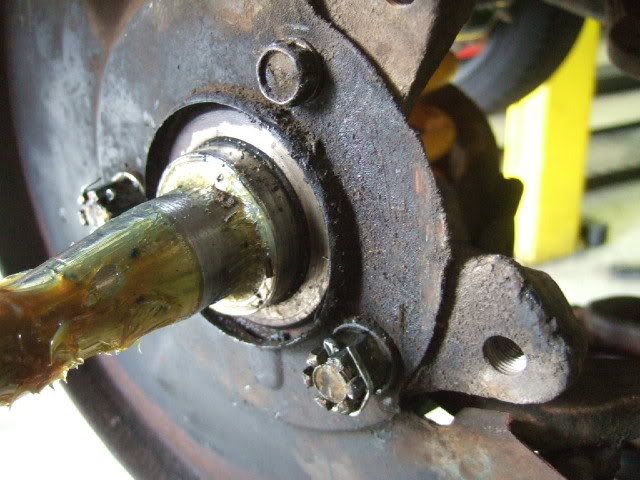

    the bolts holding the rotor to the hub foul on the split pins on the steering arm crown bolts, the split pins must wrap around the side of the nut, not over the front,
    the caliper needs to be spaced back 1.5mm back so the caliper is central over the rotor,
    spacing the caliper back ment having to space the steering arm back 3mm....,
    all mounted up, just waiting on some pads to slap in, as im not happy with the way that the RX7 pads fit...they require to much filing down.
    happy with how it turned out tho, $350 and i have brakes that will pull up
