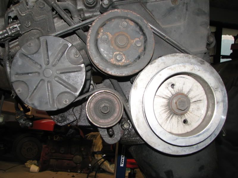

Can you take a photo?
im using the idler pulley off a magna i think it was. i don't think there bearing presses out but they are fairly cheap.
Some pictures! Got something new Adash=P?
Is that off a stock AE101 GZE? It looks totally different to mine....
Yes, I belive so. Here is a picture:
FYI that is not a stock crank pulley (looks ~175mm) or idler (stock idler would foul a crank pulley of that size).Originally Posted by defcon
So anybody know what idler i need then? confused
Edit: Looks like it has been modified a bit. Edge on one side is grinded down.
