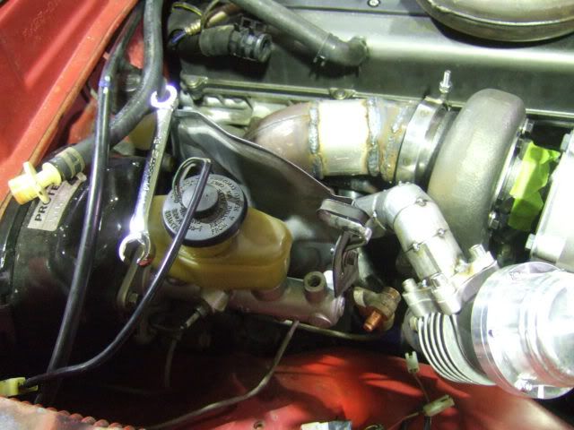

    oi, you can use a mz20 master, OR i have a new old stock mx23 master at hornsby here for you josh.... if you want it give us a bizz 0418 272 590
    yeah no probs Nick, this is why i couldnt make the cruise 2nite, busy trying to finish this shit!,
    mz20 soarer brake master and heat shield, cheers jet7m!, the rear brake line bolted straigh up, the front line i'll need to pick up a 'T' piece tomoz, and re-rout the line a lil, no drama,
