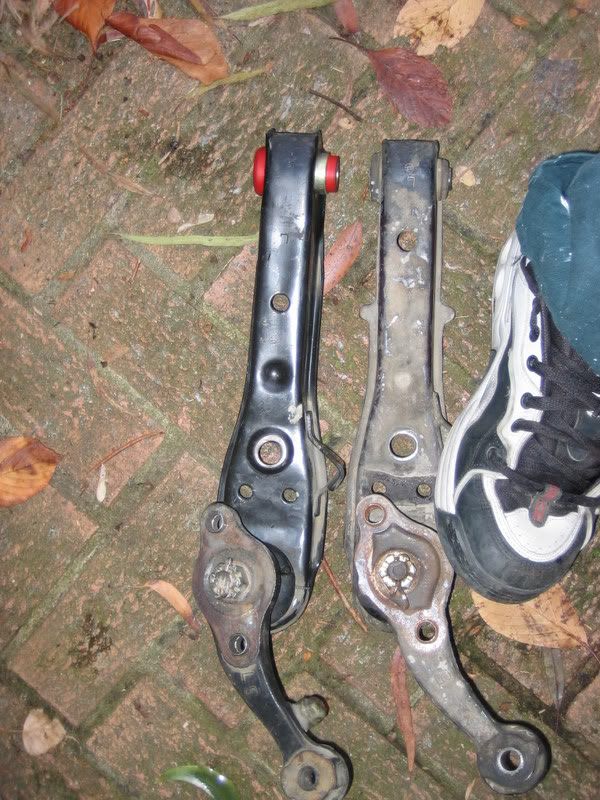

    Have you thought of puting in xt130 corona lca's. this will give you extra track, around 2degrees of camber and they bolt straight to ae86 struts/steering knuckles. swaybar link pins line up fine and you can use the standard e70 tie rods/rackend etc.
    less work than fitting sigma arms, unless you want like 5-6degrees of camber and heaps of track..
    heres the ae86 arm vs the xt130 before i put them in my ke70. (xt130 has the new red bushes)

    i really want to be able to throw it into corners...
    i had the ones in my sprinter lengthened 20mm, and it was pretty good...
    those 'rona ones don't look much longer??
    rona arms plus a strut bend maybe....

    Quote Originally Posted by MR04AG
    You only get 10mm, standard is 300mm and Corona is 310mm.
