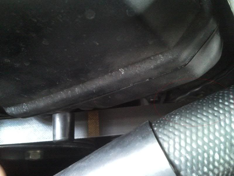

    Edit: Awesome times the accesoried belt has worn through the tape and is starting to attack the wire that goes to the CPS. Issue determined and email sent to my mechanic as well they should be fixing it as they didn't secure the wiring properly again after doing the waterpump.

    Nope but I betting it will once the wire gets cut through by the accessories belt. No Cam position sensor might make it a bit rough/not run at all.
    The wire in question has a the faint red circle around it.

    Probably won't run at all.
    Pretty common though.

    Issue resolved, mechanic paid a visit to the house to fix up their handywork.
