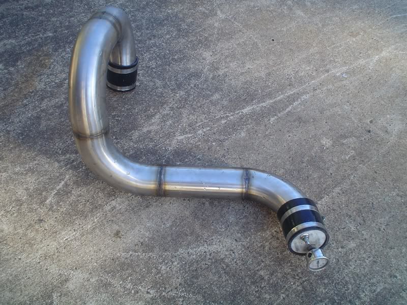

    what i did was weld a peice of 3mm plate to the end of an old bit of 3' stianless i have, then i have a guage in the top
    and the bottom is festo adjustable valve and a fitting to connect to a compressed air line.
    then you can bleed in as much air as you like, then disconnect the line and check for leaks. I stick it on the front of my turbo though so i can check the whole intercooler/piping system.
    insert ghetto paint drawing.
    EDIT: ill get a pic of it and post it up.
